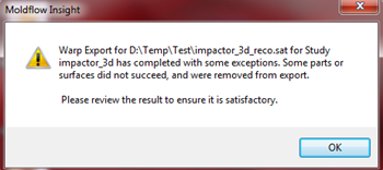

Partial export
If it is not possible to reconstruct all the surfaces, a partially reconstructed model is exported. When it occurs, once the export is complete you see a message similar to this one:
Make sure that you check the model in the CAD software before proceeding any further.
