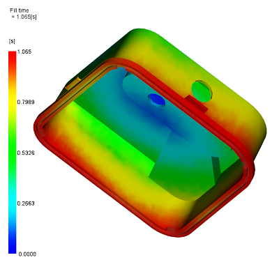

To review the Fill time results for the 1st component
  1. Click Fill time from the Results list in the Study Tasks pane.
    tank cover
    This result shows the filling pattern for the 1st shot.
  2. Animate the result. Rotate the part as needed.

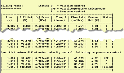

    Notice the part is about 98 % filled when portions of the material reached some of the edges of the part. The 98% is found in the analysis log at the second to last animation time step.

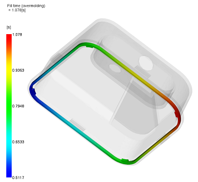

To review the Fill time (overmolding) results
  1. Click Fill time (overmolding) from the Overmolding Flow folder in the Study Tasks pane.
    seal
    Notice that both parts have a similar fill times.
  3. Make a note of the last point to fill.
