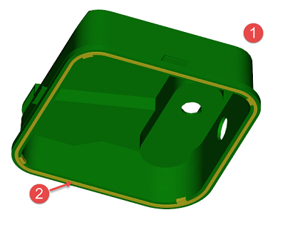

Rotate the model so you can see both parts. The first shot is the one in green (indicated as 1 in the image). And the second shot is yellow (indicated as 2 in the image).
Tip: Turn on and off the layers to help you identify the 1st and 2nd shot components and their respective runner systems.Right-click the TankSealTrimmed Tetras layer and select Hide all other layers.
Band select the entire tank seal trimmed tetras (second yellow shot).

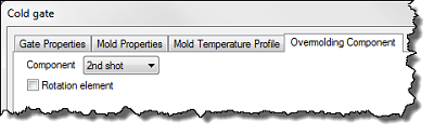

Click
(Mesh tab > Properties panel > Edit).Select the Overmolding Component tab.
Select 2nd shot from the drop-down list and select OK.

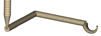

Repeat the steps above to assign all the components of this layer to the 2nd shot, including:
- Gate orifice (Cold gate 1 mm)
- Cold gate body, tapered section (Cold gate 1 x 5 mm) - edit the entire taper section
- Cold runner (Cold runner 5 mm)
- Hot gate (Hot gate 2 mm)
- Hot gate, tapered section (Hot gate 2 x 6 mm) - edit the entire taper section
- Hot sprue (Hot sprue 6)
The 2nd shot elements turn beige, as shown below.
