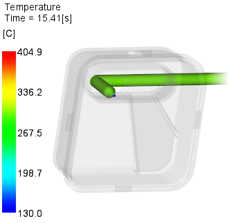

  1. Select the Temperature result in the Study Tasks pane.
  2. Find the first shot material in the database, and note the ejection temperature.
  3. Click plot properties icon (Results tab > Properties panel > Plot Properties).
  4. Select the Scaling tab.
  5. Select Specified and enter 130, the ejection temperature you noted earlier, in the Min field.
  6. Uncheck Extended color, then click OK.
  7. Animate the result and stop around 15s. Notice that the part has cooled down below the ejection temperature, 130 ºC. The only section above that temperature is where the hot runner is touching the part.
    1st shot temperature

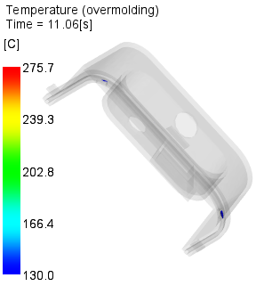

  8. Repeat the process for the Temperature (overmolding) result.
  9. Animate one step at a time to see how the temperature changes over time. You can get an idea how large the unfrozen area is at various times.
    This shows which areas, in both shots, are above the transition temperature of the first shot. Notice the last point to cool down is the last point of filling of the 2nd shot you noted in previous steps.
    overmolding temperature
