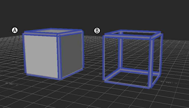

To remove the object so that it reveals only the other effects applied to it:
  • Select the object and right-click the Default shader in the Scene browser, but select Detach Default shader from Selected Objects.
    Edge Cartoon shader A. With the Default shader. B. Without the Default shader.
