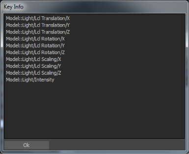

Key Info
When you right-click a keyframe, the Key Info option displays in the context menu and lets you open a Key Info window. The Key Info window displays information about the keyframe you clicked.
