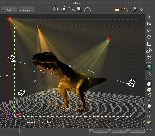

The Viewer window enables you view the current scene, select, transform and animate the elements, and set various options for displaying the scene.
It also enables you to apply effects, constraints, and devices, and to measure and display the distance between two objects.
The Viewer window is also the space where your scenes are played, the point of view that is rendered, and the stage on which the animation and models are seen.
Viewer window displaying model, cameras, lights in Producer Perspective view, and Safe Area
