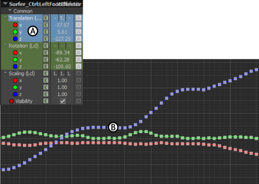

You can view your plotted data by selecting your model and viewing the function curves in the FCurves window. When you select a property on which the take was plotted, the function curve displays the plotted data. Also, these function curves display in pastel colors.
For example, the following figure shows the result of plotting a take to a cube’s translation function curves in the FCurves window.
Take plotted to a marker’s translation function curves A. Translation function curves selected B. Animation function curves displayed
