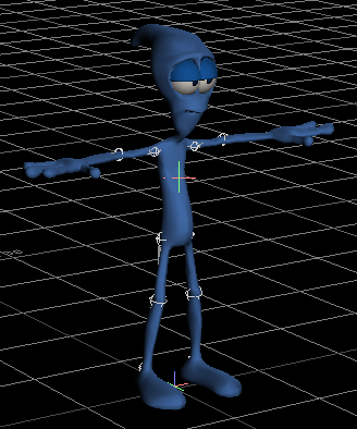

    You can now see all of the Pepe character in the Viewer window.
    3ds Max Pepe character in MotionBuilder

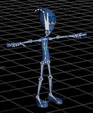

  3. In the Viewer window, select the Display menu and choose X-Ray mode (Ctrl-A).
    Viewer window Display menu
    The X-Ray mode enables you to see the character's skeleton.
    Pepe character displayed in X-Ray mode

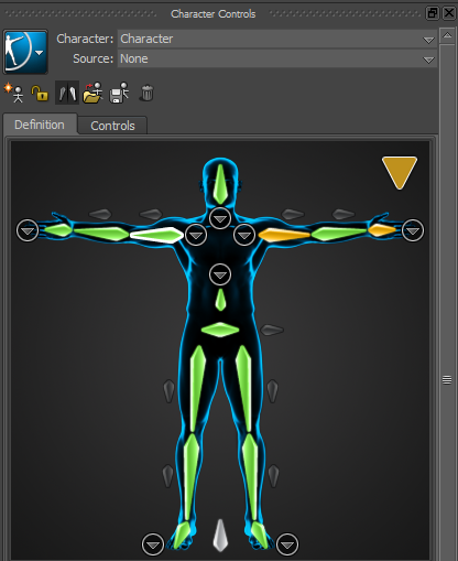

    In the Character Controls window, the Character representation in the Definition pane displays a yellow symbol ( ) indicating problems have been detected with the characterization.
    The issues with the characterization are described at the bottom right of the Character Definition pane. Hovering with your mouse over the yellow symbol also displays the issue(s).
    In this example, the right and left hands and arms don't seem to be parallel to the X axis.

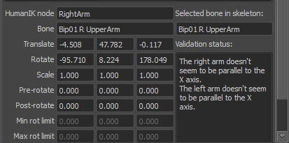

  10. In the Character representation Definition pane, click the right arm node.
    The Definition pane displays the RightArm values.

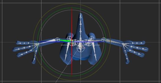

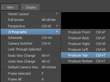

  11. In the Viewer window, click the View menu and choose Orthographic Producer Top (or press Ctrl-T).
    Orthographic Producer Top View menu option
  12. In the Viewer window Camera View Navigation toolbar ( ), drag the Zoom tool ( ) or Ctrl-drag to zoom in on the biped.
  13. In the Viewer window toolbar to the right, click the Rotate tool ( ) or press R to enable rotation.
    Pepe shown in X-Ray mode, in Producer Top view
  14. In the Viewer window, drag the outer Rotation manipulator (X, Y, Z) slightly towards the bottom until you see the Character representation display a valid characterization for the right arm and hand as shown in the following figure.
    Right arm and hand validation is valid

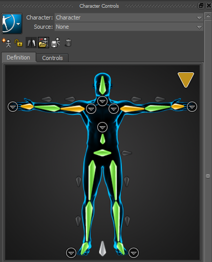

  15. In the Character representation Definition pane, click the left arm node.
  16. In the Viewer window, drag the outer Rotation manipulator (X, Y, Z) slightly upward until you see the Character representation display a valid characterization for the left arm and hand.
    The changes to the rotation values resolved the characterization issues and therefore, the characterization is valid.
    The green symbol ( ) indicates the characterization is valid.
