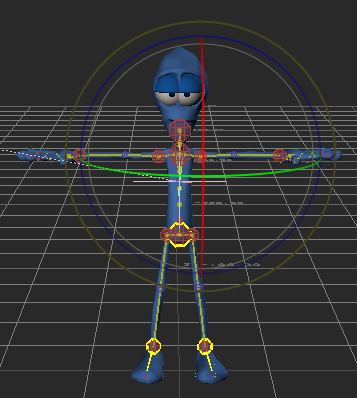

    The Control rig is created and its effectors are shown on the character in the Viewer window.
    3ds Max character is characterized and rigged
    In the Character Controls window, the Control Rig settings are activated and include all the effectors you need to animate the Control rig.
    The Character representation is an image of a human form meant to represent the biped skeleton.
    Your biped is now rigged and ready to be animated.

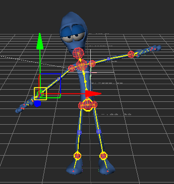

  12. Translate (move) the hand down as shown in the following figure.
    3ds Max character body follows the hand movement
    Notice as you move the hand, the arm extends and the rest of the body follows in a natural movement.
