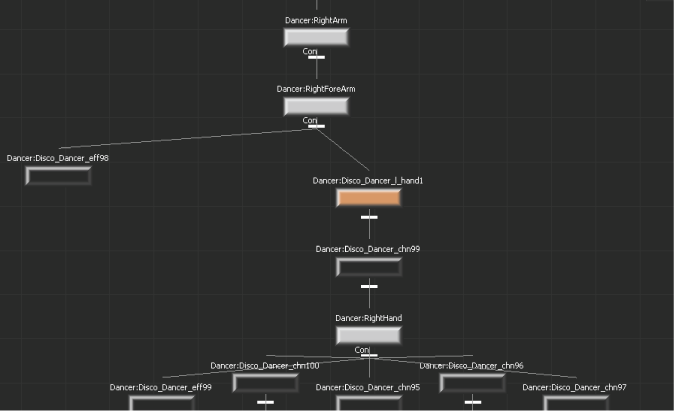

In the Schematic view, each hierarchy of nodes in your scene shows either a set of sensors from a device, the parent-child relationships of a loaded model, or the parent-child relationships you have created between objects. You can choose to display the node hierarchy of each object in the scene horizontally or vertically. See Schematic view context menu.
Tip: You can customize the color of the nodes that represent lights, skeleton nodes, and imported skeleton limbs using the color setting in the Properties window.
Depending on the position of the object in the hierarchy, you can hide entire parent hierarchies or individual child nodes. In the following figure, a model hierarchy displays in the Schematic view. The word “Con” in the Schematic view indicates that a model or other object is used in a constraint.
A model’s hierarchy displays in the Schematic view.
