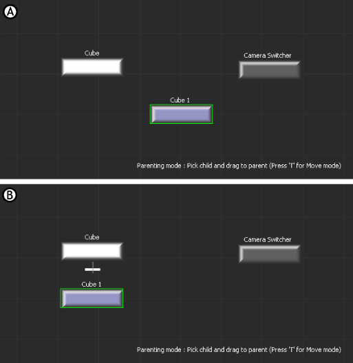

In the Viewer window:
  1. Switch to Schematic view (Ctrl-W).
  2. Press P to activate Parent mode.
  3. Double-click the node representing the object you want to select as a child. To add additional objects to the selection, Ctrl-click the corresponding nodes.
  4. Drag the selection to the parent object’s node.
    A dotted line joins a parent and its selected child objects, and the parent object is highlighted. The parent is connected to the selected children, and the objects are rearranged in a hierarchy.
    For example, the following figure illustrates two cubes before and after parenting in the Schematic view.
    A. Before parenting B. After parenting, Cube 1 is the child of Cube.
