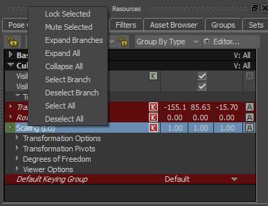

  4. Right-click, and choose select Mute Selected from the menu that appears.

  • Right-click the property you want to unmute and choose Unmute Selected from the context menu.
    The context menu displays the options available for the selected property.

  5. Right-click and choose Mute Selected from the menu that appears.
    The context menu displays the options available for the selected channel.

  • Right-click the channel you want to unmute and choose Unmute Selected from the menu that appears.
