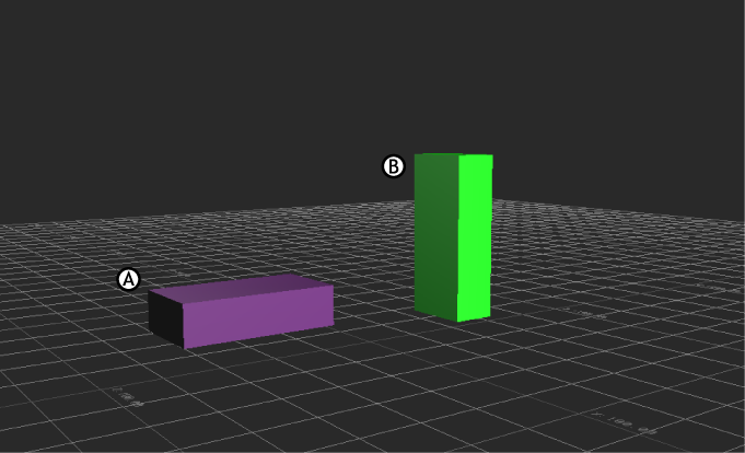

    In the following figure, the “Driver” (B) is assigned to the Reference (Ref) field.
    A basic Multi-Referential constraint example A. “Car” B. “Driver”

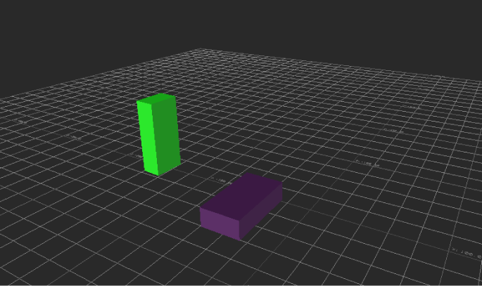

  4. Advance the scene to the moment where the Rigid object is to join the Source object.
    Advance the scene to the keyframe before the driver meets the car.

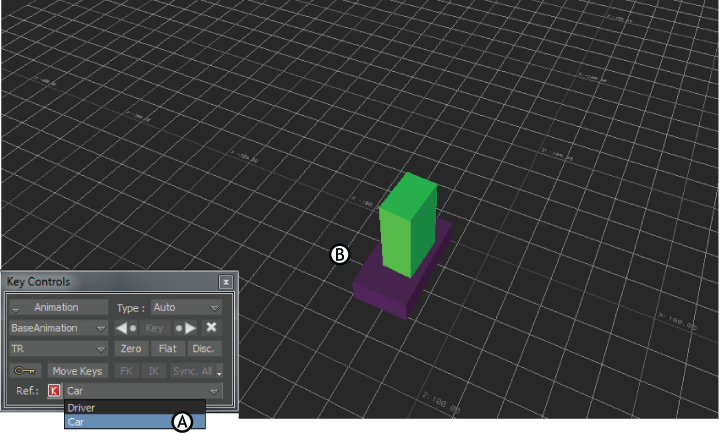

  5. Select the Source object (Car) from the Key Controls Reference menu. A Key is automatically set.
    A. Select the Source object from the Reference menu. B. The “Driver” joins the “Car” and they drive off together.

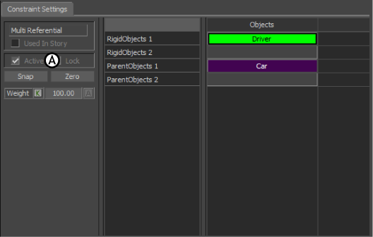

    Multi-Referential Constraint settings A. Active option
    If there are any jumps in the animation, click Sync in the Key Controls to synchronize the animation of the two objects.
