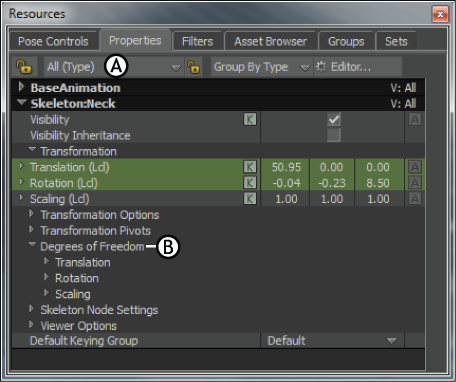

  1. Select an object, such as a Skeleton node, and open the Properties window.
    Properties window: Skeleton node properties

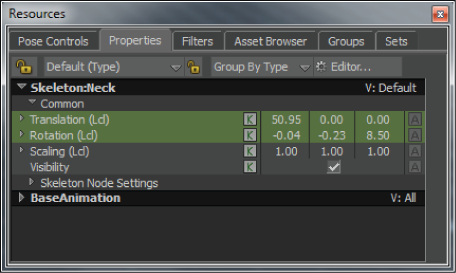

  2. Select the All (Type) view in the View menu (as shown in the following figure A) so that all available properties display, if it is not already selected.
  3. Expand the Degrees of Freedom folder (as shown in the following figure B).
    Properties window A. View menu All (Type) option B. Degrees of Freedom properties
  4. Expand the folders under the Degrees of Freedom folder to view and modify the DOF properties for the selected object.
