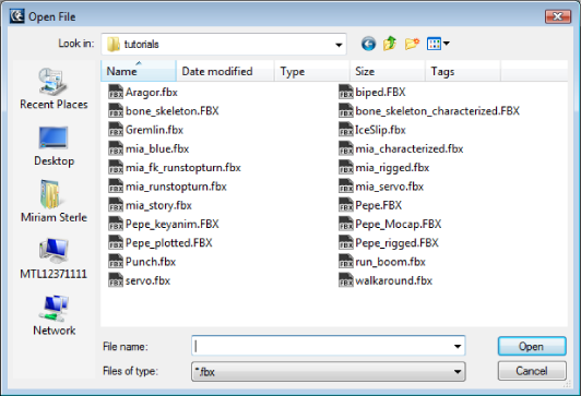

Select File > Open from the MotionBuilder menu bar. The Open File browser appears.
Open File browser
Using the File browser, select the file containing the assets you want to load and click Open.

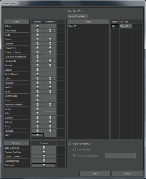

The Open Options dialog appears.
Open Options dialog box
Note: You can resize the Open Options dialog box.
The Open Options dialog box consists of the following areas:
Disable any elements of the file you do not want to load with the file.
Activate Apply Namespace if you want to prepend a namespace to objects included in the incoming file.
Click Open to open the selected .fbx file and load the selected assets, settings, and takes.
