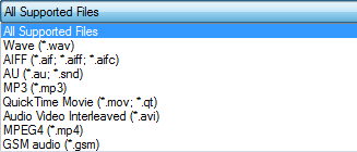

The following figure displays the supported audio files.
Supported audio file formats

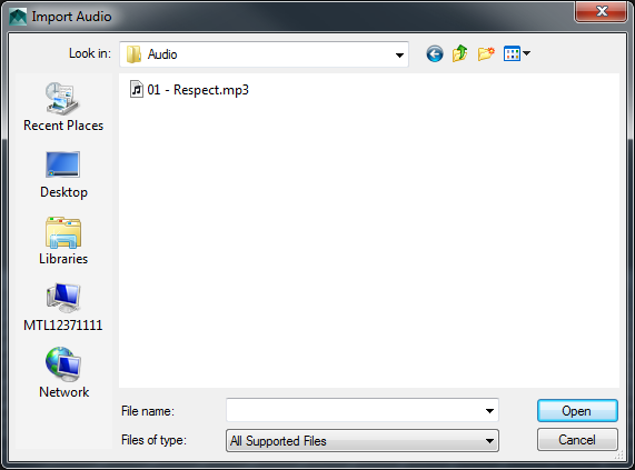

To add an audio file to a scene via the menu bar:
  1. Select File Import Audio.
    The Import Audio dialog box appears.
    Tip: In the Import Audio dialog, click the Files of type field to find out which file formats are supported.
  2. Navigate in the Import Audio dialog, select an audio clip, and click Open.
    The audio file is loaded in the scene. The Navigator window displays the audio asset in the Scene browser and the audio asset’s settings under the Audio Settings tab.
