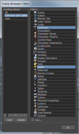

  1. In the Scene Browser, click the Filters button.
    The Scene Browser Filters dialog box appears.
  2. Click Add.
    In the Configurations pane, a new configuration is added with the default name New_Config.
  3. Rename the default name by typing a new name.
    In the Filters pane, by default, all assets are selected for adding to a new configuration.
  4. Click an asset you want to include in the new configuration. You can Ctrl-click or Shift-click to select additional assets.
    Scene Browser Filters dialog box.
  5. Activate the Locked option to lock the Scene Browser configuration and prevent it from being changed accidentally.

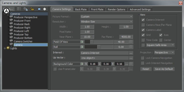

    The name of the new Scene Browser configuration displays in the title bar of the Navigator window. If the Navigator displays within a tabbed window, a tab displays the name of the Scene Browser configuration. For example, the following figure shows the Navigator using a configuration named Cameras and Lights.
    Cameras and Lights filtered Navigator window A. Cameras and Lights appears in the title bar and in the Navigator tab
