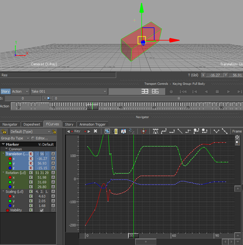

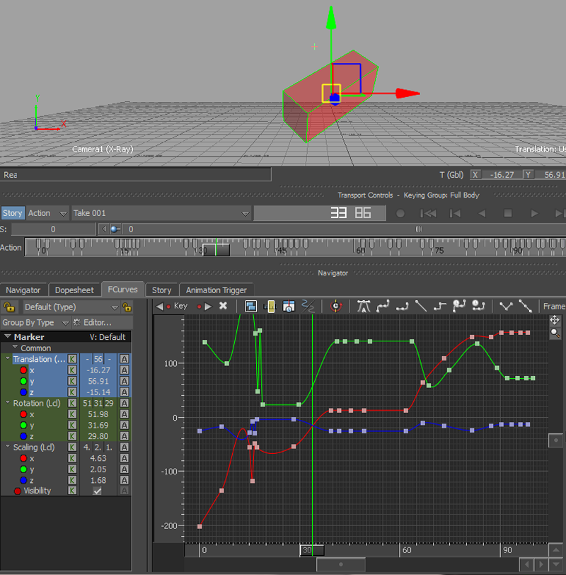

This topic shows how to smooth keys using filters. To follow the instructions, download the file and script from http://area.autodesk.com/downloads/scripts/motionbuilder-animation-scripts.
  1. Open the filters_butterworth.fbx file in MotionBuilder.
  2. Run the filters_butterworth.py script to remove the noise in the FCurve. The FCurves appear smooth as shown in the following figure.
