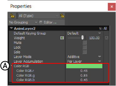

All of an animation layer’s properties that are available in the Animation Layer editor also display in the Properties window when a layer is selected. Additionally, the Properties window displays the Color RGB property.
You can open the Properties window by selecting Window > Add Property View from the main menu bar. See Properties window.
Properties window A. Color RGB property
Color RGB

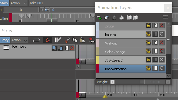

Use the Color RGB settings to change the Animation layer color hint that appears in the Animation Layer Editor, Transport Controls and Story window.
Animation created in Autodesk Maya may contain additional data, such as ghost color. When you import layered animation created in Maya, the Color RGB property in MotionBuilder displays the color of the selected layer ghost. Use Color RGB to modify the color in MotionBuilder before exporting the layered animation back to Maya.
