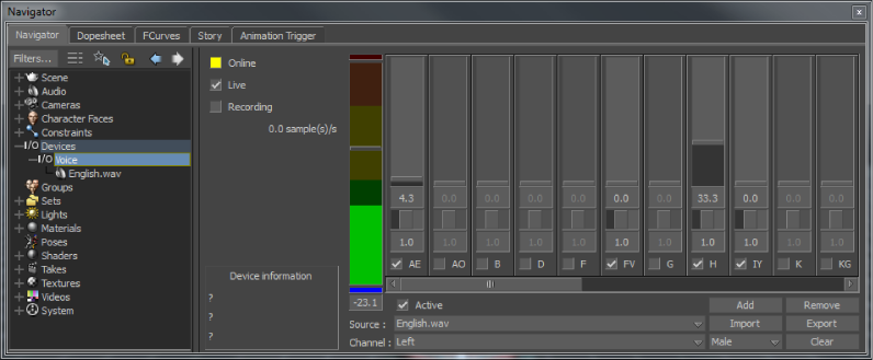

The Voice device provides voice recognition and sound analysis that let you synchronize the lip movements of up to two characters simultaneously in real time, using any language. You can also link audio files or live audio input to models, and extract various sound properties.
The Voice device identifies phonemes in the audio input so that when connected to a Character Face it can drive the shapes of your character’s head model, making the character’s mouth move with the audio.
Voice device settings in the Navigator window
