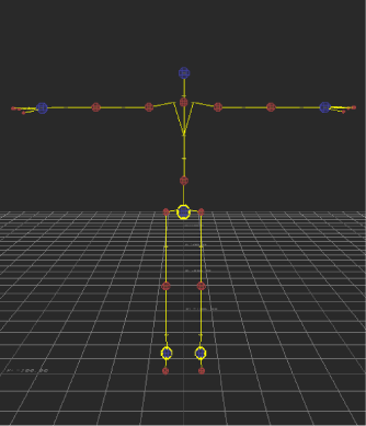

Load a Control rig into the scene.
Control rig loads in the scene
The Control rig displays in the Viewer window, and is listed in the Scene browser.
Note:The Control rig effectors only display in the Viewer window if you saved them when you saved the Control rig. See Saving a Control rig for more information.

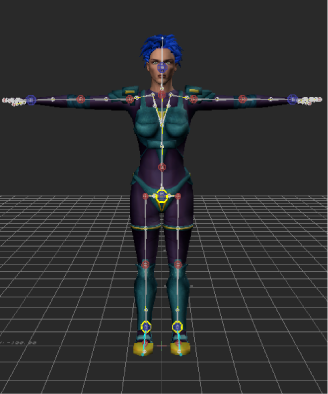

Select File > Merge, then navigate to select a character .fbx file. Click Merge in the Merge Options dialog box to merge the character into the scene.
The character loads into the scene with the Control rig, but they are not yet connected.
The Control rig is not yet connected to the merged character.
