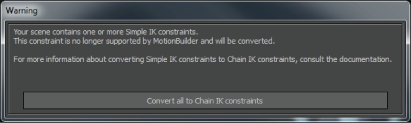

When you load a scene that contains Simple IK constraints, a warning dialog appears stating the Simple IK constraint(s) will be converted to Chain IK constraints.
Warning:
Simple IK constraints to Chain IK constraints conversion
To continue, click Convert all to Chain IK.
