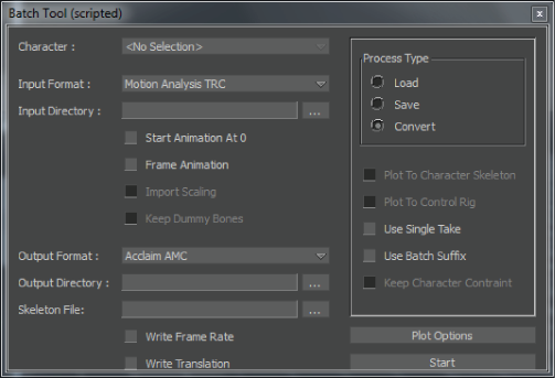

  4. Click the Batch Tool script.
    Batch Tool script
