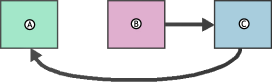

Time discontinuity happens whenever action is shown out of chronological order, for example, when you start a story with its end. The Time Discontinuity option in the Story window lets you re-order events in a scene so that they occur out of chronological sequence.
Time Discontinuity lets you edit the original sequence of events A. Third event (C) plays second B. First event (A) plays last C. Second event (B) plays first
Activating Time Discontinuity lets you play events in the animation in a different order, edit out parts, or loop the same segment more than once, without altering your source animation. For example, you could take the scene of the character walking and slipping and have the character slip first, followed by a shot of him walking.

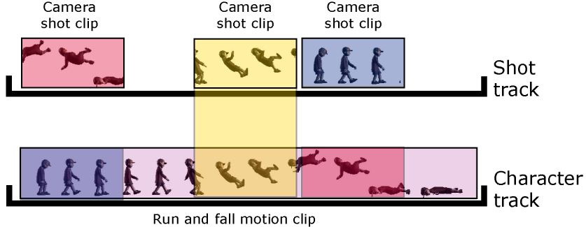

In the following figure, the scene of the character walking and slipping is shown in regular sequence. Each shot clip covers part of the action on the Character track below: the character starting to walk is covered by the first Camera shot clip, the character slipping by the second Camera shot clip and the character falling is covered by the third Camera shot clip.
Shot track showing three Camera shot clips and Character track showing an action of a character slipping
Note:
The Timeline indicators for both the Shot track and Character tracks play from left to right simultaneously to show that the Camera shots are reading the Character track’s motion in order.

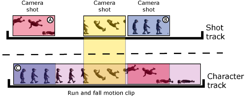

In the next figure, Time Discontinuity is activated in the same scene. Now, the position of the first and last shot clips have been swapped. Even though the action on the character track has not changed, because the shot clips that have been moved with Time DIscontinuity activated, the first shot refers to the end of the action and the last shot refers to the beginning of the action.
A. Last shot clip of character falling is at the beginning of the take B. First shot of the character walking is at the end of the action C. Action in Character track remains unchanged
Note:
When Time Discontinuity is active, the Timeline indicator for both the Shot track and Character tracks play from left to right on the Shot track, but the Character track indicator jumps back and forth through the Character track animation.
