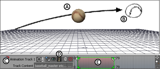

Animation clips are clips of keyframe animation you can create, save, and reuse. You create animation clips on Animation tracks to animate models and assets.
For example, when a character throws a baseball, the baseball model arcing through the air alone can be one animation clip.
Keyframe animation A. Baseball model in the Viewer window. B. A static storyboard panel used as a template. C. Animation track for a baseball. D. The track’s Animate button is active. E. Animation clip which consists of keyframes.
See Create animation clips.
