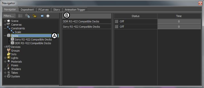

Click the Decks folder in the Scene browser to open the Statistics pane. The Statistics pane contains additional information about each VTR that has been added to the Decks list.
The Statistics pane lets you set a selected VTR status on or off and set the time offset for each VTR. You can also distinguish each VTR by entering a description.
Navigator window A. Decks folder B. Statistics pane
OptionFunction
Status optionClick to activate the VTR. When disabled, the VTR is not controlled by MotionBuilder.
Time fieldUse the Time field to set a time offset for the VTR.
Description fieldUse this field to enter a description that distinguishes each VTR.
