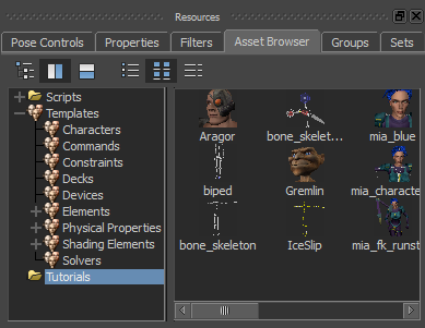

  3. In the Asset Browser Resources window, click the Tutorials folder.
    The contents of the Tutorials folder appear in the display pane, in Thumbnails display by default.
    Tutorial assets displayed in thumbnails

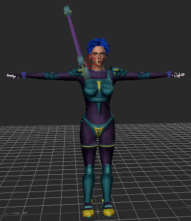

  5. Select FBX Open No Animation.
    A model named Mia (mia_servo asset) appears in the Viewer window in the T-stance as shown in the following figure. This character includes a “Servo arm” that is parented to the right shoulder bone and added as a Character Extension.
    Mia in the T-stance, with a Servo arm
    In the Character Controls window, Mia is shown by default as the current character in the Character menu.

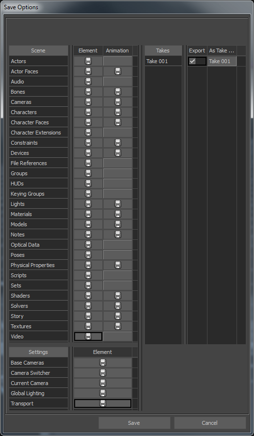

  7. Navigate to a directory other than the default MotionBuilder Tutorials directory where you want to save the file and click Save.
    The Save Options dialog box appears.
    Save Options
  8. Click Save.
    Choosing to save the file to a directory other than the default MotionBuilder Tutorials directory ensures you do not overwrite the original .fbx file.
