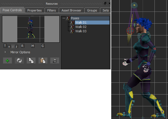

  1. In the Pose Controls window, under the Pose Thumbnail, activate the Mirror Match option ( ).
  2. Go to frame 12.
    • In the Transport Controls, enter 12 in Timecode field ( ).
  3. Paste the mirrored Walk 01 pose on Mia.
    • In the Pose Controls Pose browser, double-click the Walk 01 pose.
    The Walk 01 pose is pasted and mirrored onto Mia. Because you mirror-pasted the pose, the left leg is now forward, and the right leg is behind to continue the walk cycle on the other side.
    Frame 12: First pose for the second half of the walk cycle
    Note:
    The hips effector was de-selected for this screenshot.
  4. Set a Flat keyframe.
    • In the Key Controls window, click Flat.

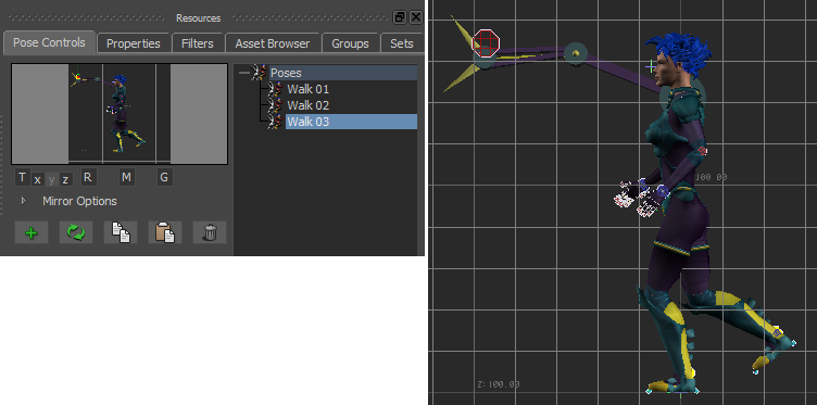

To mirror the third pose:
  1. At frame 20, paste the Walk 03 pose on Mia.
    • Go to frame 20.
    • Double-click the Walk 03 pose.
  2. Set a Flat keyframe.
The Walk 03 pose is pasted and mirrored onto Mia. The result should be similar to the following figure.
Frame 20: Third pose for the second half of the walk cycle
