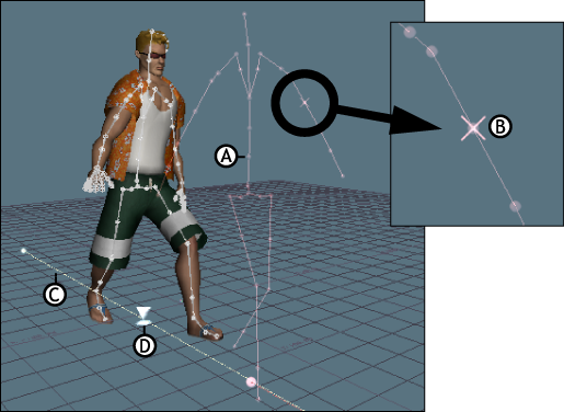

Story ghosts A. Clip’s model ghost B. Match object ghost C. Clip vector ghost D. Travelling node
A track has a model ghost, a match object ghost, and a travelling node. A clip has its own model ghost and its own match object ghost, as well as a clip vector ghost.

Models have ghosts when the models are a track’s content (the selected asset of a track). For example, when a character is selected in the Character field of a Character track, the character’s model ghost looks like the character’s skeleton. When a cube is selected in a Track Content field, the cube’s model ghost is a circle.
When a clip is selected, the Model option lets you hide and show the clip’s model ghost. A clip’s model ghost is the same color as the clip.
When a track is selected, the Model option lets you hide or show the track’s model ghost. A track’s model ghost is white and represents the result of all the animation in the track.

When a clip is selected, the Clip Vector/Travelling Node option lets you show or hide the clip vector ghost for a selected clip. When a track is selected, the Clip Vector/Travelling Node option lets you show or hide the track’s travelling node.

The Match Object option hides or shows the match object ghosts of tracks and clips. Ghosts of match objects look like crosses in the Viewer window. See Matching clips for more information on match objects.
