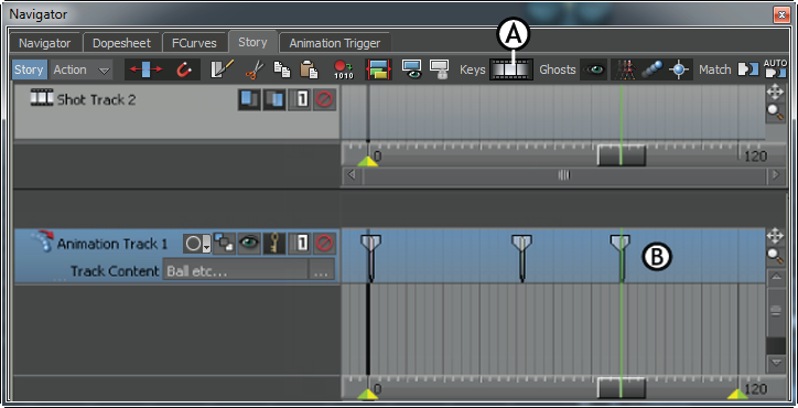

When the Multiple Clips option is active, clips are automatically created along the track as you move the Timeline indicator and transform selected assets. A clip is created for each keyframe.
Story window A. Multiple Clips option set to active B. Clips created for keyframes at frame 0, 49, and 81
The color of the clips on the track represent the keyframes they represent.

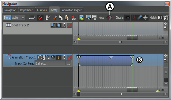

When the Multiple Clips option is disabled, only one clip is created when you transform selected assets. When the option is disabled, the clip stretches to include the keyframes you set.
Story window A. Multiple Clips option disabled B. Clip encompassing keyframes at frame 0, 49, and 81
You can change the contents of a keyless clip by placing the Timeline indicator over it and transforming the selected assets again.

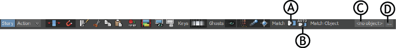

Story controls A. Match Options button B. Auto Match option C. Match Object field D. Match Object button
The Match Controls are active only when an animation, camera animation, or character clip is selected. See Matching clips for more information.
