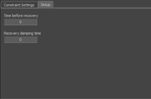

Once you have assigned Source and Constrained objects to a Rigid Body constraint, click the Setup tab in the Constraint settings.
Rigid Body Setup pane
Enter a value in the Time Before Recovery field.
Enter a value in the Recovery Damping Time field.
Note:MotionBuilder measures these fields in frames per second or timecode format, depending on the settings in the Global Controls.
