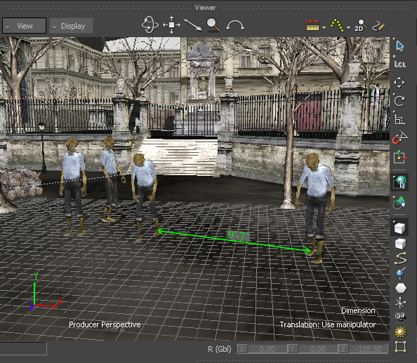

The Dimension object is displayed in green when selected and the Viewer window indicates it is selected by displaying Dimension at the bottom right, as shown in the following figure.
Dimension object shown selected

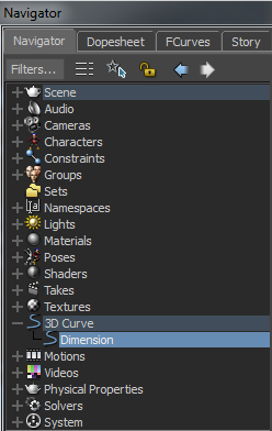

When you save the Ruler "object" as a Dimension object, the Dimension object is saved as a 3D path. You can access the Dimension object in the Navigator Scene browser, in the 3D Curve branch.
Dimension object saved as a 3D path

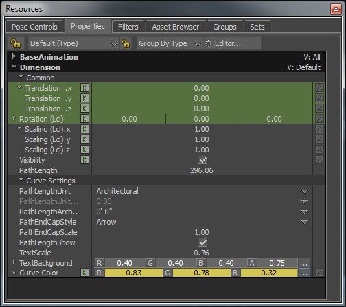

If you click the Dimension object in the Navigator Scene browser, its properties are displayed in the Property Resources window.
Dimension object properties
The Dimension object properties in the Property Resources window are the Dimension object properties you can animate, enable, or disable.

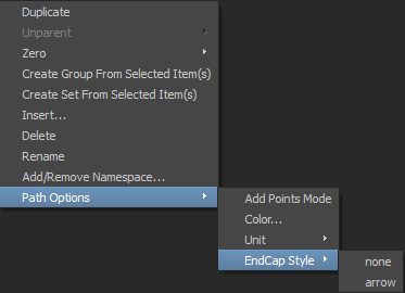

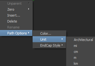

The Dimension preferences are accessible via the Ruler tool (
) Preferences context menu, via the menu bar Settings
Preferences, and via the Dimension object context menu in the Viewer window.
