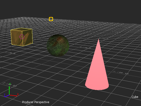

  3. Hover over the object whose pivot is offset and press B.
    Note:
    Unless a Ruler is being created, the keyboard shortcut B is also used when working with optical data to multi-select items to create a Rigid body or a Rigid body constraint.
    The object is highlighted, and the object's bounding box centre (displayed as a Magenta hexagon) and the Rotate and Scale pivots are displayed, enabling you to snap to the bounding box centre of the object.
  4. Click the pivot offset and then release the keyboard shortcut.
    The system Ruler "object" start point snaps to object's pivot offset.

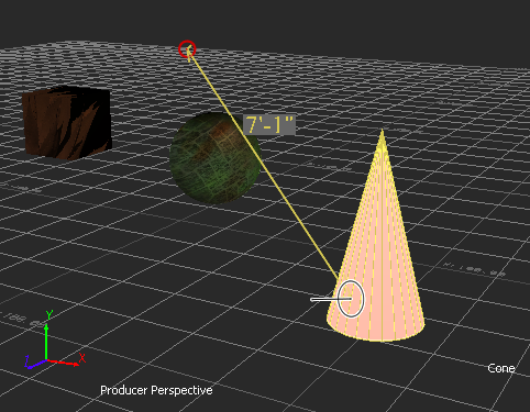

  5. Hover over the second object.
    The measuring distance updates as you start to move the cursor.
  6. Click-hold to select a surface of the second object.
    The cursor changes to a 3D cursor ( ).
  7. Release the cursor.
    The system Ruler "object" end point snaps to the surface of the second object. The measured distance between the pivot offset of the first object and the surface of the second object is displayed.
