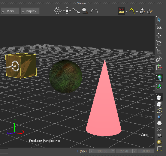

).Hover over an object.
The object highlights.
Click-hold until the cursor changes to a 3D cursor (
) enabling you to snap to the surface of the object.The 3D cursor is shown snapping to the surface of the cube.
Position the cursor and release.

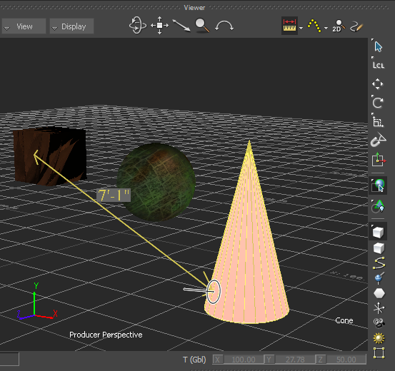

The system Ruler "object" start point snaps to the surface of the object. The measuring distance displays and updates dynamically as you start to move the cursor.
Position the cursor to the desired location on the surface of the second object and click-hold.
The cursor changes to a 3D cursor (
3D cursor is shown snapping to the surface of the second object
Release the cursor.
The system Ruler "object" end point snaps to the surface of the second object and displays the distance between the two objects from their surfaces.
