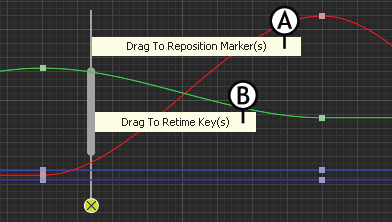

  4. Double-click on the FCurves pane to add retime markers around segments of the animation curves you want to retime.
    Note:
    Add a single marker to reposition the marker or to ripple all animation out from a single point.
    Single retime marker added A. Time bar (thin upper and lower part) to reposition the marker B. Handle (thicker middle part) to retime animation

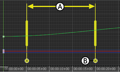

  5. Add two or more markers to retime the time span between them.
    For example, in the following figure, two markers are added at frames 5 and 20 to retime animation between them.
    Retime markers A. Solid line between markers B. Delete icon
  6. To exit the retime mode, click .
When there are multiple retime markers, a solid line displays between each pair of markers. It indicates that dragging either marker affects any keys between the first marker and the next. Dragging two retime markers further apart slows the motion between them, and dragging them closer together speeds it up.

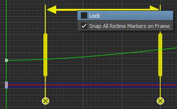

Locking time span between two markers
You can lock the time span between two markers to move the segment in time, without scaling or adjusting the shape of the curves within.
To lock the time span between two markers:
  1. Right-click the solid line that appears between two markers.
  2. From the context menu, select Lock.
Activating the Lock option disables the adjustment of FCurves within a segment as you drag the retime markers.
Locking a segment of animation is useful when you want to retime multiple keys together, without adjusting the shape of the curves. Once the segment is locked, drag the markers to shift the entire segment to a new location in time.

Snapping markers on the nearest frame
When you drag a marker, you can choose to snap it on the nearest frame or to maintain the last position of your movement. By default, all markers are snapped on the nearest frame to each marker.
To disable snapping of markers to the nearest frame:
  2. From the context menu, deselect Snap All Retime Markers on Frame.
    If you disable snapping, then the marker appears on the same frame where you created.
