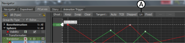

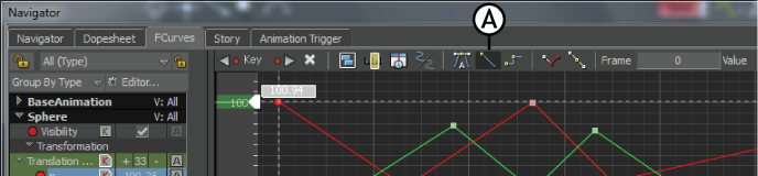

To change the interpolation of a keyframe to Linear:
In the FCurves window, select the keyframe or keyframes whose interpolation you want to change.
In the Tangent options, select Linear to set the interpolation type.
FCurves window (detail) in Classic Mode A. Linear interpolation type selected for the keyframe selection
FCurves window (detail) in Updated Mode A. Linear interpolation type selected for the keyframe selection
