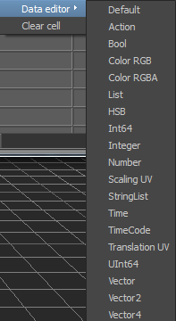

Data Types
There are 19 data types shown in the Data editor:
Expression constraint data types
The following table lists and describes each expression constraint data type.
