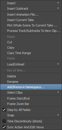

You can add namespaces of object names to their corresponding story tracks. To make this possible, the Add/Remove Namespace option is added to the Story window context menu. Clicking this context menu option, displays the Add/Remove Namespace dialog box with all the namespaces added to the scene objects.
To add namespaces to story tracks:

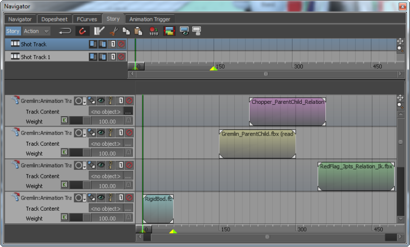

From the Story window, select one or more story tracks, right-click on them, and select the Add/Remove Namespace context menu option.

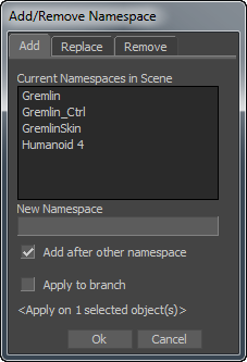

The Add/Remove Namespace dialog box appears. By default, the Add tab displays all the namespaces that are added to the object names.
From the Current Namespaces in Scene list box, select a namespace and click Ok.
The namespace is prepended to the names of the selected story tracks.

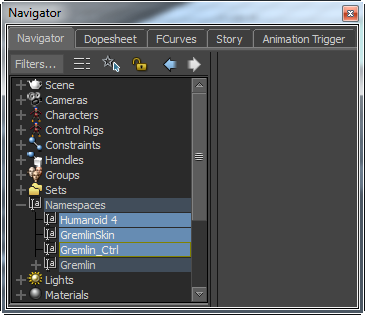

Notice that all the namespaces in objects are displayed in the Navigator > Namespaces folder.
