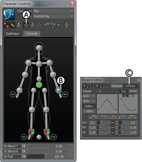

When Full Body is selected in the Character Controls window, the Full Body option is active in the Dynamic Editor. When this option is active, the keyframes on all effectors are modified, even when only one effector is selected. You can also toggle back and forth between the Selected option and the Full Body option when modifying animation.
Character Controls window A. Full Body mode selected B. Selected left wrist effector C. Full Body option

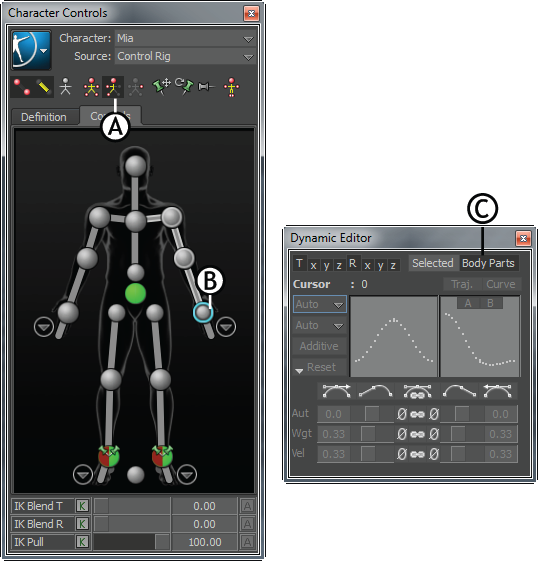

When Body Parts is selected in the Character Controls window, the Body Parts option is active in the Dynamic Editor. When this option is active, the keyframes on all effectors that belong to the body part of the selected effector are modified. You can also toggle back and forth between the Selected option and the Body Parts option when modifying animation.
Character Controls window A. Body Parts mode selected B. Selected left wrist effector C. Body Parts option
