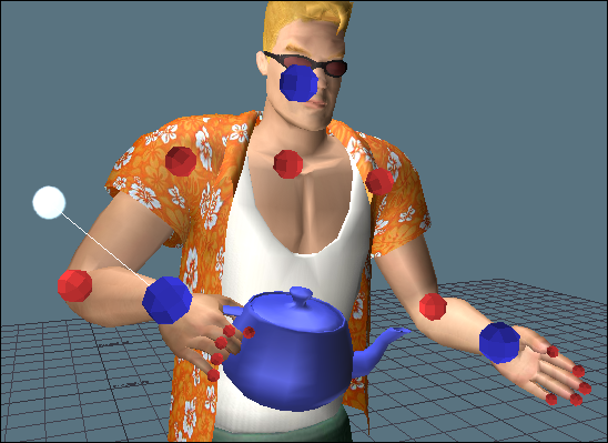

Handle attached to the character’s wrist.
This way, a Handle lets you select and manipulate a group of unrelated objects.

In the image above, a Handle is attached to the model’s wrist effector and a teapot model. You can then use the Handle to move both objects together.
