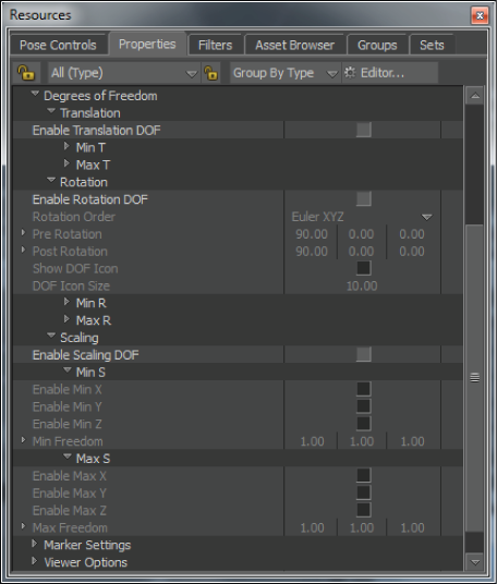

Properties window: Degrees of Freedom properties
Degrees of Freedom for translation let you define the coordinates an object is allowed to occupy on the X-, Y-, and Z-axes. For rotation, Degrees of Freedom properties let you define the angles an object can rotate through on the X-, Y-, and Z- axes. Degrees of Freedom properties for scaling let you limit the size of the selected object.
