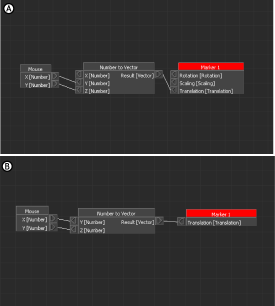

To sever connections, right-click either the Sender or the Receiver and select Disconnect from the context menu. The white line that displays between connectors disappears and the connection is broken.
Senders and Receivers have many connectors. Often, not all of these connectors are used within a relation.
To hide the unused connectors, right-click the Senders or Receiver’s name and select Hide unconnected from the context menu to increase the amount of free window space.
Relations constraint A. Connectors showing B. Connectors hidden.
If you right-click an empty area in the Relations pane you can select an option from a context menu to show or hide all unused connectors.
To show the unconnected connectors, right-click the name of the Sender or Receiver that has its connectors hidden and select Show Unconnected.
