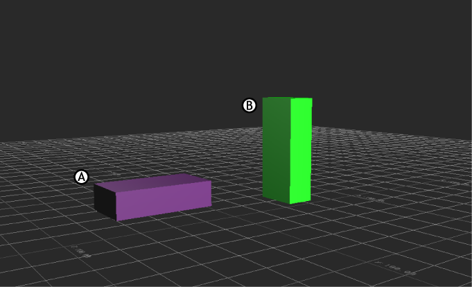

In the following figure, the “Driver” (B) is assigned to the Reference (Ref) field.
A basic Multi-Referential constraint example A. “Car” B. “Driver”

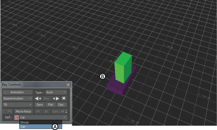

Select the Source object (Car) from the Key Controls Reference menu. A Key is automatically set.
A. Select the Source object from the Reference menu. B. The “Driver” joins the “Car” and they drive off together.

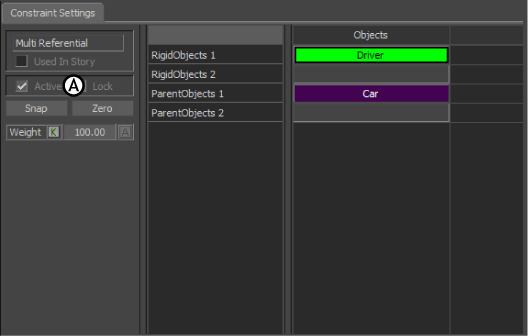

Multi-Referential Constraint settings A. Active option
If there are any jumps in the animation, click Sync in the Key Controls to synchronize the animation of the two objects.
