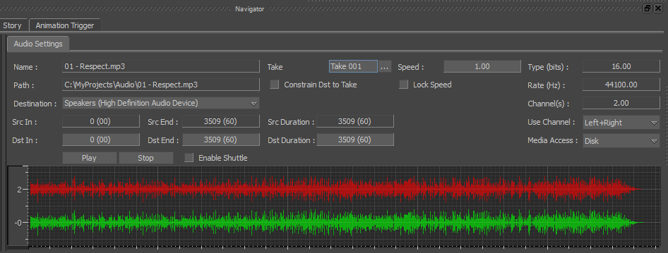

The audio settings display in the Navigator window when an audio clip is selected in the Navigator Scene browser. The audio settings consist of the audio properties and the audio waveform.
Navigator window Audio settings

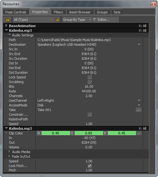

The audio properties are also available via the Properties Resources window.
Resources window displaying audio properties

Audio waveform area
The waveform area shows a waveform of the audio file loaded in the audio settings.
If only one channel is displayed in the waveform area, your audio file is playing in Mono. If you know that the file is not a Mono recording, verify your audio device settings.
When an audio file is loaded into the Audio settings, a waveform also appears on the Action timeline in the Transport Controls window.
