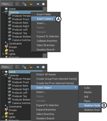

Insert
Lets you add an asset to your scene where
For example, right-clicking the Cameras folder lets you add a custom camera, while right-clicking the Scene folder provides an additional submenu, letting you add any object.
Insert
Insert

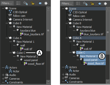

Select/Unselect Branch
Selects or deselects all the assets connected to the branch that you right-click. For example, right-clicking on a cube and choosing Select Branch selects the cube and its child assets.
Select Branch A. Right-click on Cube C and choose Select Branch. B. Cube C and all its child assets are selected
You can also use Select Branch and Unselect Branch with Asset folders. For example, you can right-click the Textures folder and choose Select Branch to select all the textures in your scene.
