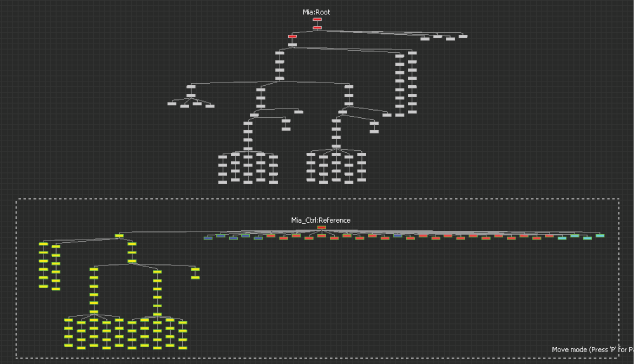

  1. In the Viewer window, switch to Schematic view (Ctrl-W). Select all of the nodes in the Control rig you want to save.
![](../images/select_ctrlrig_schematic.png)
Select the nodes of Mias Control rig in the Schematic view.

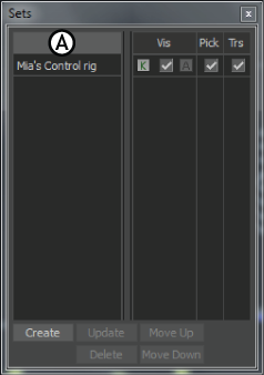

  1. Right-click the set, select Rename from the context menu, and rename the set to reflect the name of your Control rig.
![](../images/sets_window.png)
Sets window *A.* Renamed set containing Control rig
