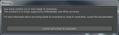

Simple IK constraint conversion
When you load a scene that contains Simple IK constraints, a warning dialog appears stating the Simple IK constraint(s) will be converted to Chain IK constraints.
Simple IK constraints to Chain IK constraints conversion
To continue, click Convert all to Chain IK.
