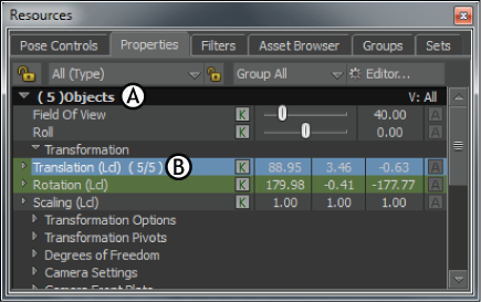

Group All
All selected elements are grouped together, letting you modify common properties at the same time for all selected elements.
For example, in the following figure, five objects are selected. These five objects are all grouped together under the heading “5 Objects” (A) to indicate that their common properties can be edited together (B).
Properties window A. Grouped objects B. Grouped objects’ translation properties

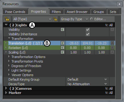

Group By Type
Elements of the same type are grouped together. For example, in the following figure, the lights are grouped (A). You can modify the properties of all models at the same time, but modify the properties of lights separately from models.
Properties window A. Grouped objects of same type B. Grouped objects’ translation properties

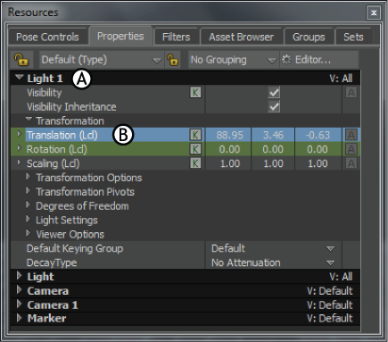

No Grouping
All elements are listed separately, letting you modify each property individually without affecting other elements. For example, in the following figure, all selected objects are listed one after the other.
Properties window A. Light 1 is not part of a group B. Light 1 translation properties
