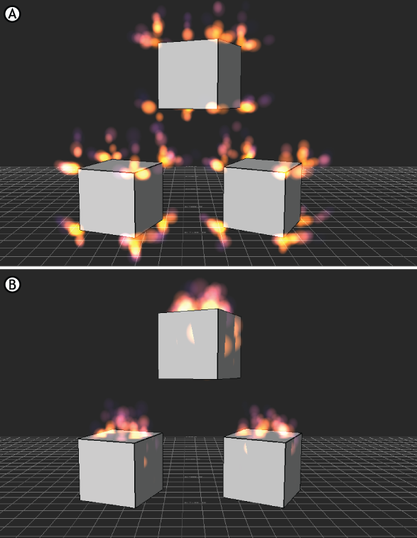

Emit From
Use the Emit From menu to select from two particle display options:
Vertex
Emits particles from the model’s vertices.
Scaling Volume
Emits particles from the model’s scaling volume
Emit From menu options A. Particles emitted from vertices B. Particles emitted from Scaling Volume

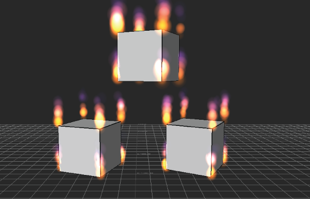

Normals Dir
Deactivate the Normals Direction option if you do not want particles emitted along the object’s normals.
Normals Direction disabled

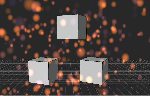

Emit Radius
Use the Emit Radius slider to increase or decrease the radius of emission around a source.
Emit Radius value set to 100%.
